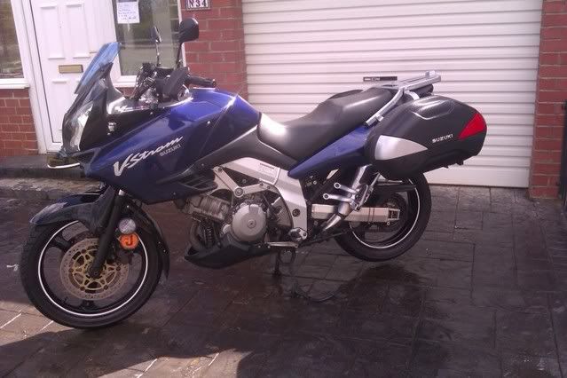

« Reply #51 on: April 08, 2012, 15:21:09 »

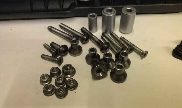

14) Suzuki Rack and Panniers, re-coloured carbon/silver
After a wet 320 mile trek out, I came home with a wide load!
The rack has rust all over so the sensible thing was to strip it down and have it repowder coated. While that's away being blasted, zinc coated and then powder coated silver, I took all the nuts, bolts and fittings I remove and sent them through a wire brush attached to my drill. I also painted the spacers to stop them rusting.
Before
After a wipe over with ACF50

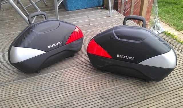

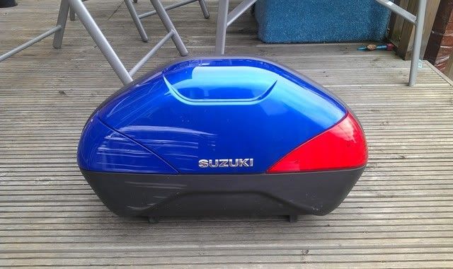

Next the panniers have a few battle scars on them, and as they don't match my bikes colours, I decided to do some painting and carbon wrapping.
HERES some useful info regarding securing the panniers
Pannier rack now back from coaters, heres a couple of pics with them fitted.
Does my bum look BIG in this?

Re: KevShek' DL1000 K3 - with Mods & How To's
« Reply #52 on: April 11, 2012, 12:22:26 »
Looks grand with the carbon wrap even though I'm not much of a fan of carbon fibre. Some ACF-50 on those nuts, bolts and spacers will keep the corrosion at bay for longer.
« Reply #53 on: April 11, 2012, 18:53:58 »
Just read the whole thread , some great mods and pics . I like the carbon wrap , is it easy to do ?
I can't stop adding things and changing things on mine .
« Reply #54 on: April 11, 2012, 20:25:12 »
That carbon wrap job there looks excellent, kevshek, a great solution to the problem you had - it also looks like the sort of thing it would be easy to *@#& up. Mine would probably resemble the wrinkled hide off an elderly elephant , if I tried it...
Offline kevshek
  • Joined: Feb 2012
  • Posts: 320
« Reply #55 on: April 11, 2012, 20:56:39 »
The carbon does take a bit of practice, bit its quite forgiving. You need an old hair dryer, aswell and extra hands sometimes, bit I've had a lot of practice. It's good for hiding things or just even to give some contrast.
My car for example, I bought used and had no choice in the colour. It's a solid dark blue which is kind of naff, but I dressed up the car with a front splitter, sideskirts and rear diffuser, yep, you've guessed it..... In carbon.
If you mod it, They will come!
