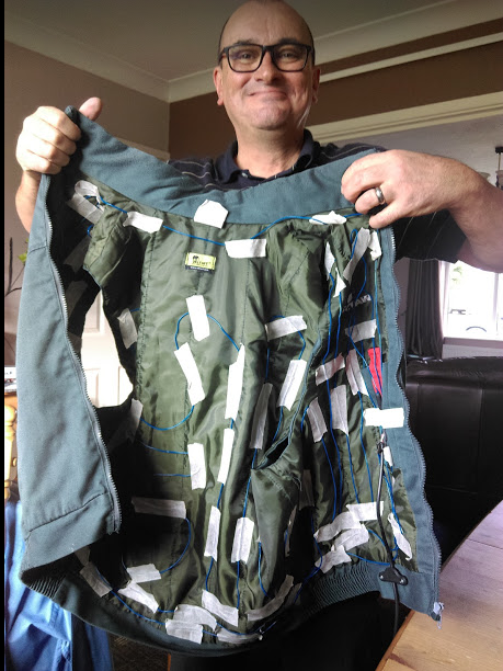

Following on from the Hondaman heated seatcover from the early spring season range, the autumn/winter season brings us to an update.
I removed all the heating element  (a long loop of wire), the control unit and skillfully attached it to a retired body warmer using the most cutting edge adhesive materials available. (Masking tape and box tape).
I then turned my attention to the electrical connection interface with the Nail. A simple quick release plug unit was called for, after searching online catalogues for a suitable coupling I instead went for an item from my own stock. A defunct Sky box donated it's power in socket, the male plug was soldered to the jacket. I used a Volvo split charge relay to power the device, the relay is only live when the 'bike is charging so hopefully no flat battery.
Connected everything up, fired up the Nail and Hello presto toastyness.

Do you have any way of controlling the heat or is it a on/off affair? Didn't your DIY insoles lead to a burned foot? Did you do anything technical like measure the resistance of the wire to workout the power draw? :D Give me a shout if you find you want to control the heat.

It does indeed have heat control, low, off and high. Low is a pulsed current, high is continuous. High is 4.5 amps, 41 watts. Low is plenty warm enough. The initial carbon fibre insoles did indeed inflict actual bodily harm. :shy: There is still a small scar...
Thanks for the kind offer Bigpie, I'll drop the GPS round one day this week.

Yeah....  great.  :thumb: I like DIY stuff. Although you might need something a little heatproof (linen not polyester)  between you and the "HOT WIRES to prevent localised overheating.
