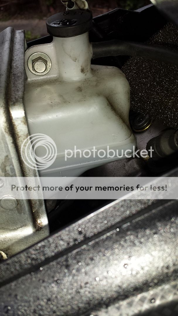

Well today I stripped it down.  First check was coolant level:
Phew all OK.

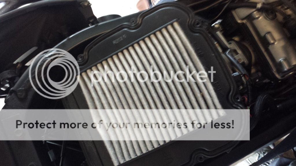

Next check air filter:
Not too bad (was supposedly changed at a service at 11,056 miles on 05 Dec14)

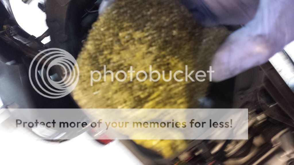

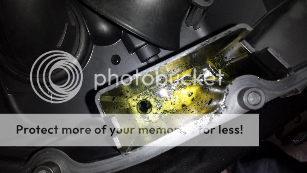

Next remove air filter to check breather hose...   :shock:
 :bawl:  :bawl:   :-x  :-x  Holy crap!!  Well that explains that!  So thoroughly cleaned the sponge,  including decreasing and drying.  Cleaned out the air box -  fortunately the sponge contained it.  Ran the engine at idle for 15 mins. Re-cleaned air box again.  Ran engine at idle for 20 mind,  then went through the rev range for a few minutes.  Re-created and reinstalled everything including a new(ish) K&N filter (thanks Zippy) and ran engine for another 5 mins.
I think it's starting to clear a bit though am concerned by the amount of crap uncovered  today in the air box.  I'm going to check it out over the next few weekends in advance of a trip to Scotland at the end of the month.
Am still concerned by the amount of crap in it- stuck my finger in the oil filler opening and inside seems caked.  I might buy some Motul engine clean and change the oil/filter again (only changed 200 miles ago and the dropped oil didn't look too bad).

Looks like cleaning the sponge in the air box has helped.
Looks like regular(ish) cleaning through winter might be the answer... checked the sponge today and it's nice and clean,  though a bit of water collected in the bottom of it.

No response from Suzuki/dealer yet, so took the tank off yesterday. Found the same as UK_Vstrom650 in his above photos. But the foam was all squashed down at the bottom which may have restricted the breather somewhat. So I'm hoping it may be a bit better now its fitted correctly  :shrug:
Shall see over the next week or 2.

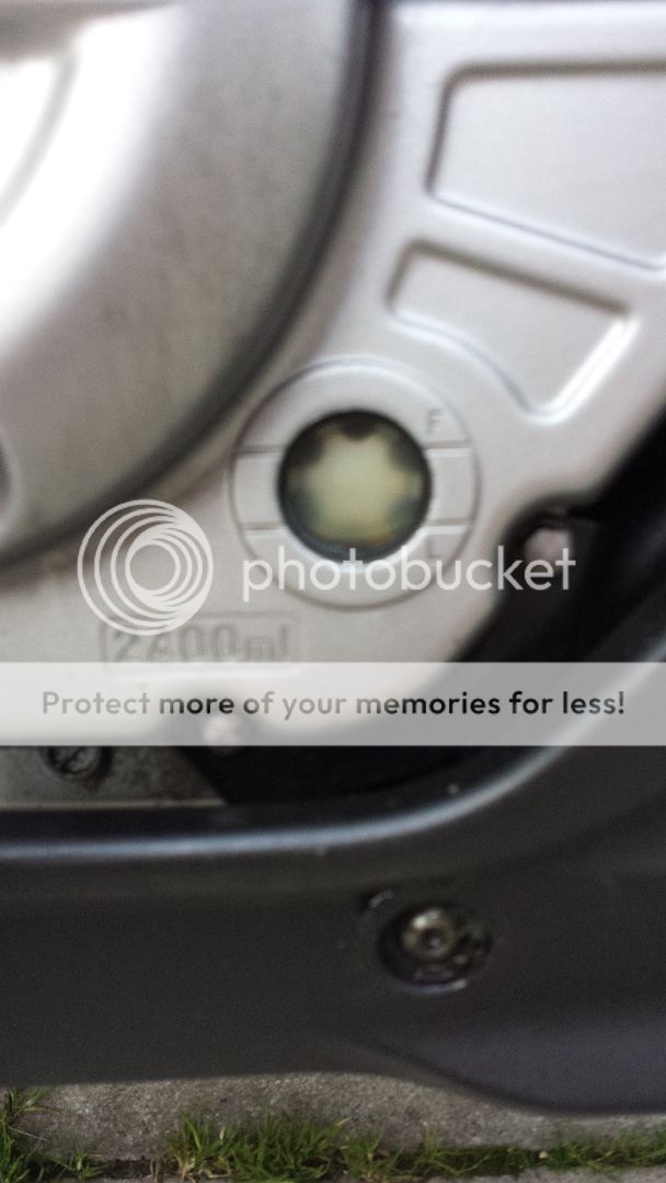

« Reply #34 on: May 30, 2015, 19:17:20 »

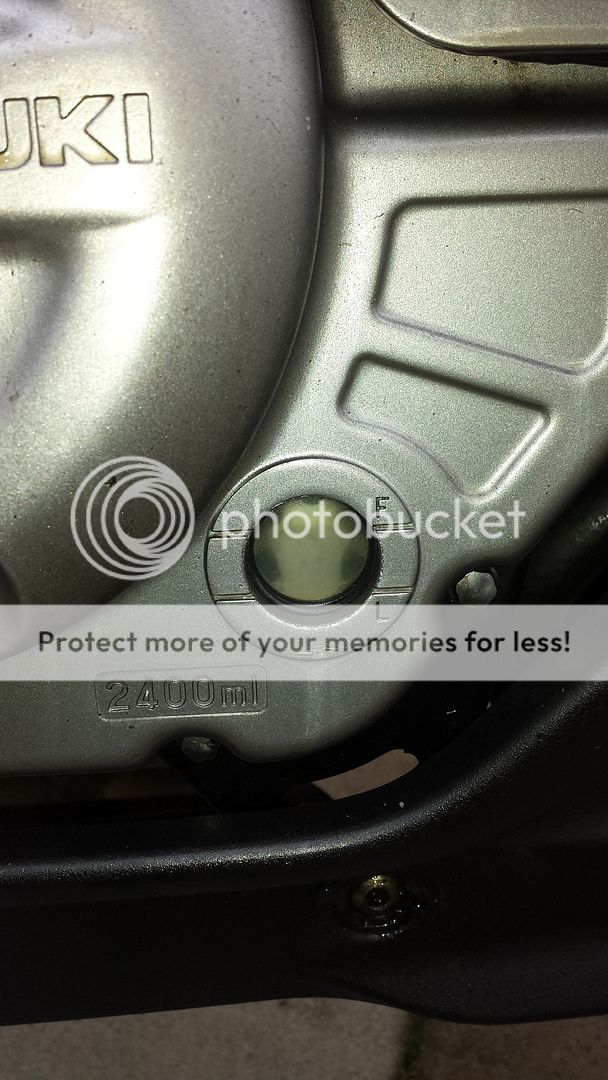

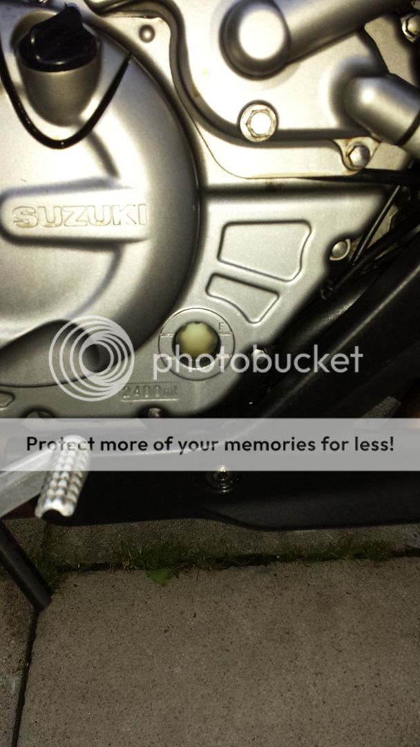

Went into the dealers today for the free oil change.
My oil window still looked like this when I went in.
Left the dealers & decided to have a nice leisurely 30 mile ride to get home. Once home, checked the oil window & it was completely clear. I was rather surprised it had an effect so quickly.
Don't know if it was the new oil or different brand. Make of it what you will.
Popped back down to the dealers (they're only 2 miles down the road) & they seemed as surprised as me.
Anyway I'm happy now.
Also I was going to do an oil change before going on a euro tour in a few weeks - so its saved me £20 as well :)
If the same happens after next winter, I'll just do an oil change.
Offline Mel
  • Joined: Jul 2013
  • Posts: 47
Re: New info on Milky Oil
« Reply #35 on: May 31, 2015, 04:35:48 »
What oil did you have before? The same now?
Offline UK_Vstrom650
  • Posts: 6938
  • Bike: DL650A L2
« Reply #36 on: May 31, 2015, 07:28:30 »
Looking good Sam.
My money is still on the foam being squashed down causing this long lasting issue. Now you've sorted that & had fresh oil in whatever water was in there has evaporated off.
I've used a few brands of oil and usually get milky oil through winter, although this year it wouldn't have cleared unless I sorted that squished foam out.
