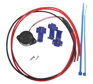

I also tried something else not related to the headlights and that too did not work. I got an indicator buzzer that beeps when the indicators are on. This is to enable me to hear a beeping sounds incase I forget to switch them off (happened a few times). Connected the red wires to the positive wire of the indicators and the black one to earth.
The indicators work fine but not the buzzer. Connected the black wire to the negative of the battery directly; still nothing. Connected the red wires of the buzzer to the positive of the battery directly (each one individually) and the buzzer worked fine.

This is the buzzer I connected

Re the indicator buzzer what earth did you attach the black wire to? You can't earth to the frame on these bikes so you need to scotch lock it into one of the earth wires connecting to the indicators.
I have connected one of them up to my sons first bike to get him into the habit of turning the winkers off and they work well.

As regards the buzzer, I connected it with scotch locks to the positive wires and the eart I took directly off the battery.

BTW, Scotch-Locks are terrible devices. They tend to cut wire strands and they are prone to rust. Posi-Taps and Posi-Locks are much better.
