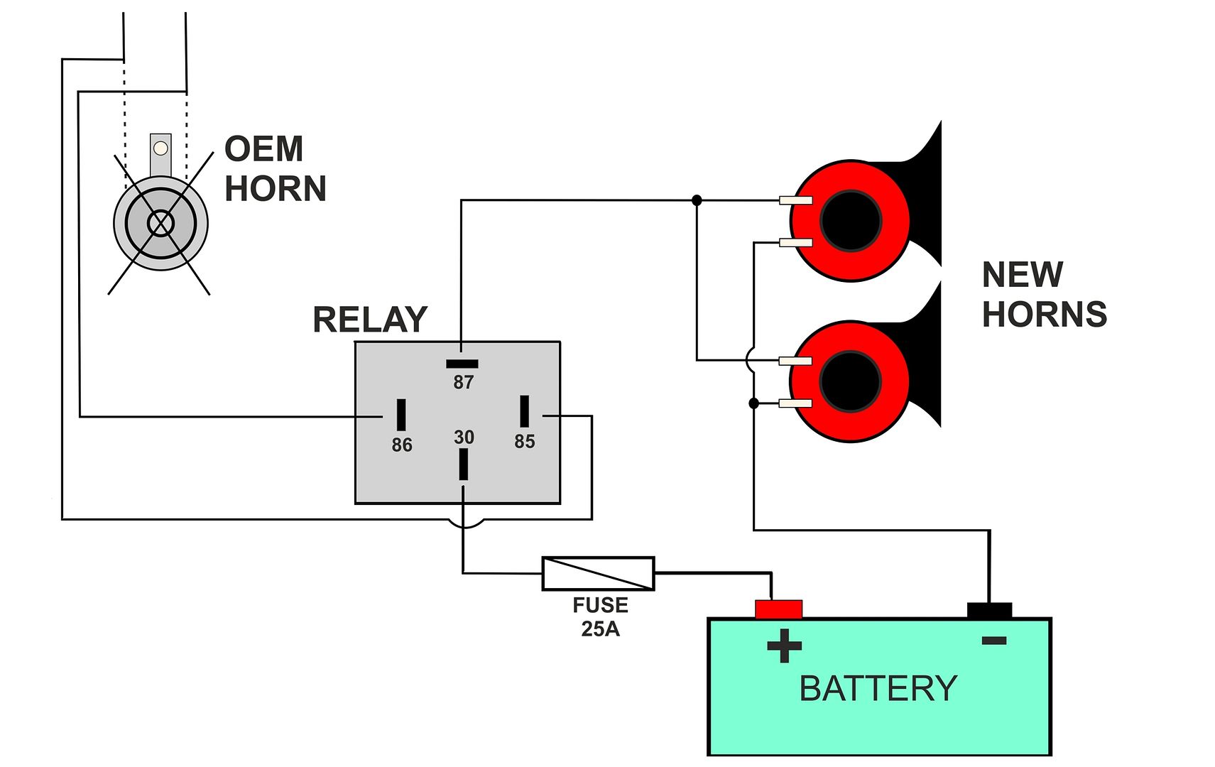

Here I made a little diagram on how to connect new horns. Don't worry about polarity of wires coming from OEM horn, they just serve to trigger the relay and the polarity doesn't matter.
Make sure positive from battery goes as on the picture.
On new horns, I also didn't care about polarity, as long as both horns are turned the same way, I mean, parallel contact to be done is, for example, left terminal on one horn to left terminal on the other horn, then right one on the right one, you know what I mean.
Anyway, here it is:

Excellent diagram, bosnjo!  :)  :clap:

bosnjo, that's outstanding - thank's very much for posting this diagram. It's pissing down today so I have had to postpone the horn mod YET AGAIN!  :angry-screaming:
